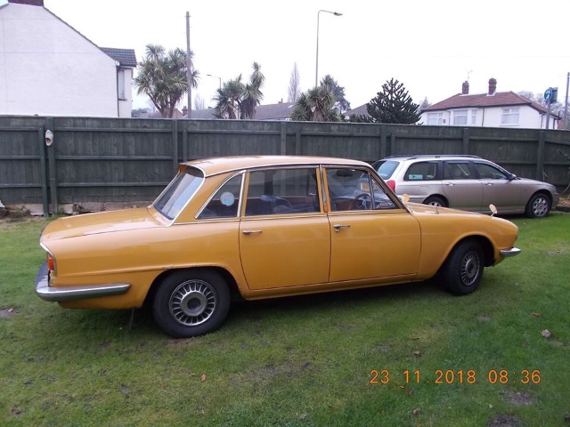

We were impressed by the abilities shown by the various big Triumph saloons on the RBRR and agreed that that’s what we would need for the next RBRR in 2020. The search started for a car, the initial budget wasn’t vast, but we can put money into the car as we go along. We went to look at various cars, some truly appalling and way over-priced. I saw our car on a Facebook Cars for Sale page, posted by Dave Marshall. As it happened I was at the NEC the following weekend at the November Classic Car Show on a non-Triumph club stand and Dave very kindly brought the car along on the Saturday lunchtime for a short test drive.
The car has some faults, but was honestly described by Dave and it felt like it was something that we could work with. The deal was done and Martin and I drove up to Redditch to pick the car up. Martin drove it home with me in the chase car, we got home in one piece and met the following weekend to assess in detail what we had bought. It’s a 1971 2000 in Saffron.

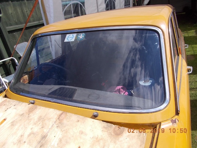

Well the head is back on after full rebuild, head skim, valve stem guides, 3 angle cut valves and seats.
Screen out to fit new rubber and good secondhand SS trim.

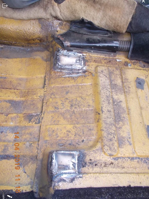

Front seats out to be replaced with MG ZT (Rover 75) sports seats. Found that the rear of the original drivers seat mounts were cracked and the floor pan where the seat runners had also cracked.
Need to fix the floor pan before mounting the new seats.

Re: Rusty Custard
Neat looking welding Chris!
Re: Rusty Custard
I wish it were mine! Mine has yet to progress beyond advanced pigeon s**t.

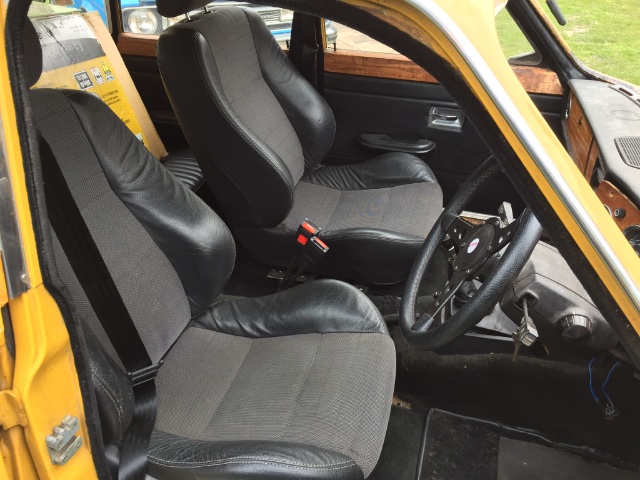

Re: Rusty Custard
Seats in now, really comfortable, with lots of side support.

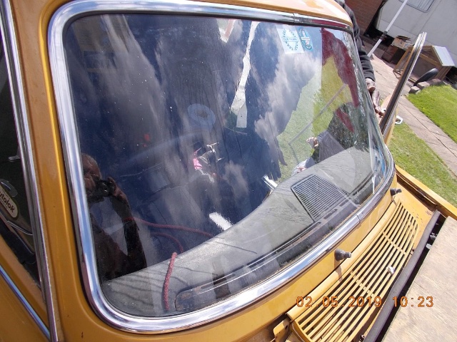

Re: Rusty Custard
Original windscreen, new rubber, now with shiny windscreen surround.
