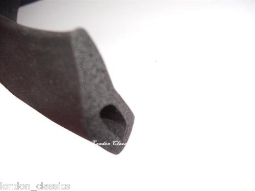

I'm still getting a leak inside even after re-sealing the windows, it's much better, but still not sorted, so I had the watering can out, and it appears the boot seal is about as much use as a chocolate tea pot! Removing the boot carpet and trim revealed a a good 2" of water slopping about in the wells. Both the small drain tubes through the boot and wheelarch were blocked so I've cleaned those out, but I'm not convinced on the seal. Mine is fitted with a sponge type affair, and is glued on in a couple of places, I'm thinking it should be a proper rubber job to provide a decent seal?

I couldn't see the first image, but the boot seal did change in production. Early ones are glued to the boot lid itself while the later ones clip to the lip around the boot, very much like the 2nd image you showed.

Thanks Mike, the boot does tend to sit proud of the wings, but the lock is on it's lowest adjustment already, and I can't see any way to adjust it further, unless I elongate the holes.
I've attached the first image rather than link if it's not showing.

AFAIK, the earlier type of seal (the one glued to the bootlit pressing) was always of near-rectangular section, not the 'blade' type shown in your first illustration.
I don't know why the change in section was made in the mid-1970s, whether it was to address shortcomings in performance or merely to save costs by commonising with a section in use on other vehicles. During the body restoration some years back, however, I was advised to opt for the later type unless originality was of prime concern, as it was reckoned to provide a more reliable seal...
