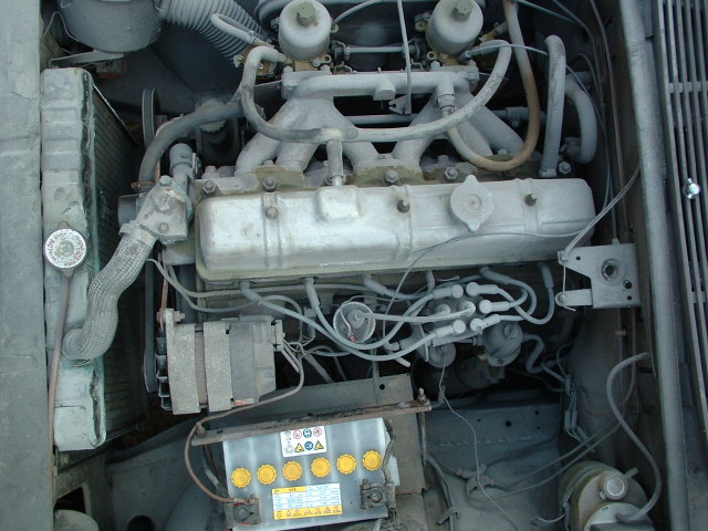

HS4 are 1.5", HS6 are 1.75". Did you get a different inlet manifold too? The HS6s go on a longer inlet manifold that has a thin air 'box' and a flexible trunk to a single air filter down by the radiator. HS4's are probably on a short manifold with a separate air filter for each carb, but a different manifold than used by the Strombergs. If you measure the diameter of the carb where the air filter goes, that should be 1.5" for HS4s or 1.75 for HS6s.
If the needles you got from Burlen didn't fit, it would suggest that they are not for the carbs you have.
Here's a picture of the HS6s in my 2000. Sorry about all the dust!
You can see the long inlet manifold.
You can lean out the mixture by screwing in the adjustments, but although you could probably get it OK at idle, if the needles are wrong the mixture will be wrong at different engine speeds and loads.
If you take out a needle you can see it's type. The numbers/letters are stamped around the boss where it fixes into the air slide thingy. I have lists for the needles used in the big saloons and I can look them up, but will be away for a week so won't be able to until next weekend.
