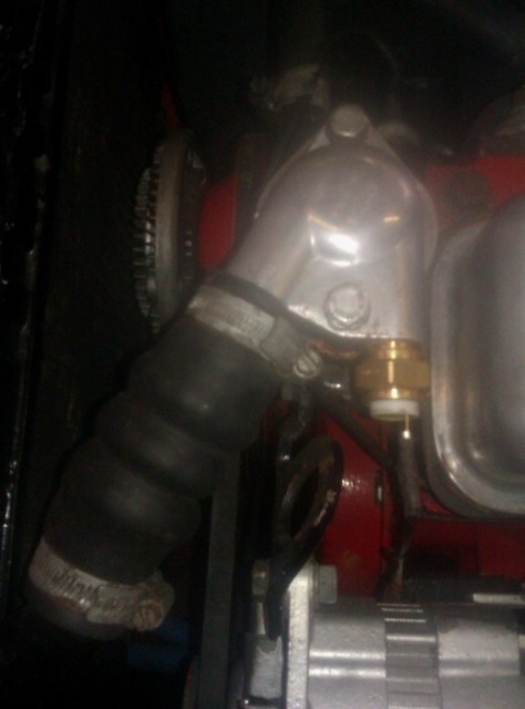

by Carboy0
Pinched off another forum.

I think that would be ideal as it will sense the temperature on the radiator side of the thermostat. Until the thermostat opens you're not really bothered as the engine isn't up to temperature. Once the thermostat has opened, then the temperature either side of the thermostat should be the same. Assuming the thermostat is working OK that is!
When you say 'thermostat housing' I assume you mean the top bit as in your picture? I should have some around too if Chris can't find you one.
