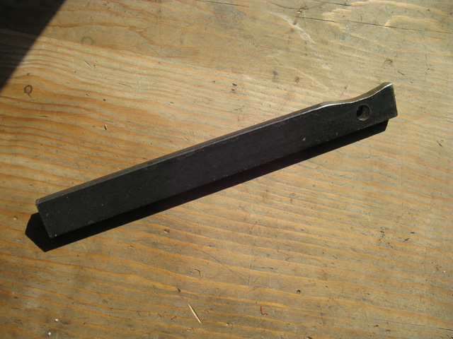

Done this myself recently, you need something handy to hold the gearbox flange when you unscrew the retaining nut.
I'm not keen on wrenches around the collar, so use a piece of flat bar like the photo below - bolt to the gearbox side of the flange and hold while you loosen and re-tighten the flange retaining nut. Its a piece of 25x10mm flat bar about 250mm long with a 10mm hole with a relief ground out to clear the flange collar. Anything similar will do as long as it is stout enough not to bend.
