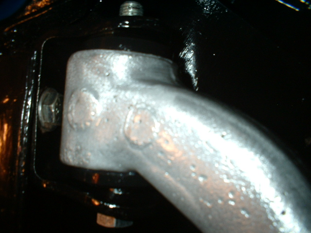

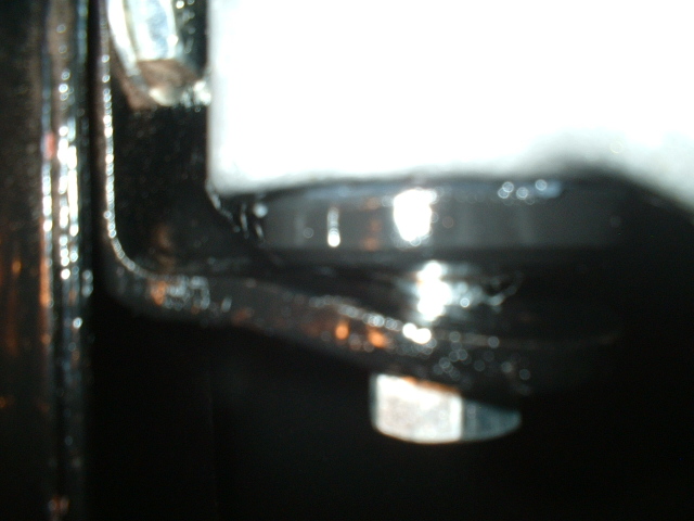

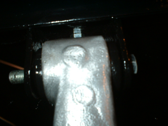

Some pics :

Am hoping the pics give an idea - first two maybe not but hopefully the third gives an idea - unfortunately a combination of not a lot of 'headroom' , my focusing not being brilliant due to hayfever season and an ever growing mid-drift
made close up photography a trifle challenging this evening
Am aware of 'opening up ' being a course of action for some but how much...Am wondering whether to try G clamping the bend back before bolting up - as I see it at present with the bend to the open end - surely the bolt head is just going to cut into the bent out portion,as the bolt head is not 'seating' to a flat surface but an angled one. If you see what I mean.

That's a bloody mile away. you'll have to either shorten the tube or get the correct one's IMO, and straighten the shackle bracket.
