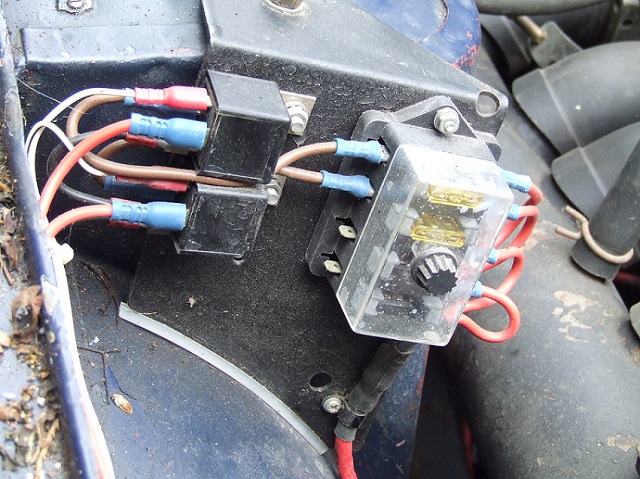

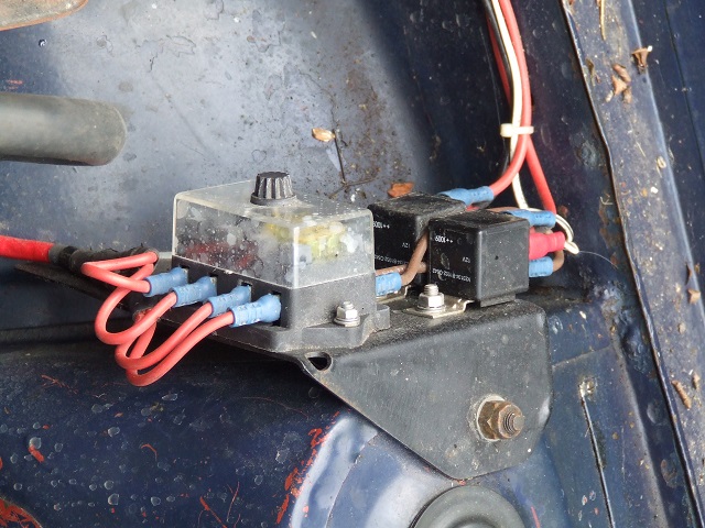

On a Mk2, the headlight wiring goes down the drivers side in the inner wing and can be extracted through one of those triangular holes just forward of the suspension turret. The relevant wires can then be cut and re-made as required. I made up a relay plate to mount around there (off one of the strut top nuts!) which then gets the relay coil power from the dip switch and feeds switched power back out to the headlamps themselves. 'All' you need then is 0V and a power feed. The former can come from anywhere around there, and the latter I took from the starter motor main feed (suggested by Jonathan on here!). You must fit fuses to protect the wiring so I fitted a 4-way fuse box on the same relay plate, using just 2, one each for the dip and main relays.

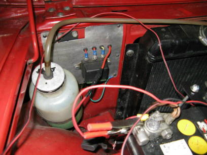

I've mounted my relay on the other side, closer to the battery. Completely rewired in heavier gauge cable. Best lights I've ever had.

I did my 2000 that way, but when I came to do the PI and after communicating with Jonathan, I decided to try the other side, especially as the wiring to the headlights is all there too.tony wrote:I've mounted my relay on the other side, closer to the battery. Completely rewired in heavier gauge cable. Best lights I've ever had.
I was concerned about the live feed, but it was Jonathan who suggested picking it up from the starter motor.
Agreed about the light output. It is fantastic - far better than the boss's modern Volvo and my 20 year old Jag!
I'll try and remember to take a picture to post..

Re: Halogen conversion kits
I've found a couple of suitable pictures of what I did. Sorry about the dead leaves - it was probably done in the Autumn!
Thanks Mike, looks very neat...
