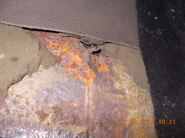

We’ve been checking around the bodywork for rust on found plenty - of course. The passenger footwell has rotted out at the base of the bulkhead. My question is whether there is a panel available to be welded in or do we need to fabricate something?
All advice welcome

Thanks Dave, a lot of the rust is in the more upright bulkhead section, where it joins the floor pan, I don’t suppose there’s a panel for that as well?

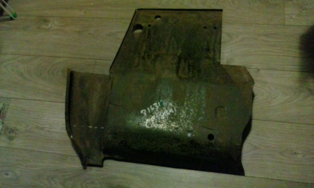

Lloydpiestate
- Posts: 492
- Joined: Thu Jan 01, 1970 12:33 am
- Location: cardiff
Re: Replacement floorpan
the panel you require will be pressed next year, i have just managed to obtain this NOS one for use as a pattern, the o/s will be pressed and the n/s will be fabricated, unless i can find a NOS n/s in the meantime.
i might press the whole panel or just 15" from the bottom upward, the price i am waiting on will dictate
lloyd
lloyd
