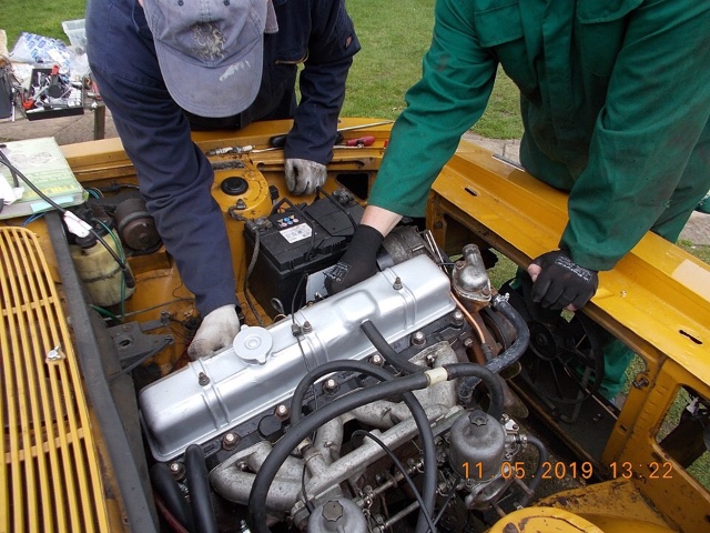

Re: Rusty Custard
Good day and a bad day on Rusty.
Fitted the longer bottom rad hose - fitted new water pump - fitted new thermostat housing with take off for rad fan switch.
Wired the fan switch up through relay and tested the existing Kenlow fan, we couldn’t get the coolant hot enough to trigger the fan at 90 degrees, so will test another day in a cup of boiling water.
Attention then turned to the rear end to diagnose the clunk on take off. Well what can I say, there’s about 15 degrees slack between the crown-wheel and pinion and a little slack in some of the drive-shaft UJs and one of the sliding splines.
So we need a budget solution, does anyone have a spare diff unit? The existing one is from the original 2.0 litre, although the engine is 2.5 litre, so will happily pull a 3.45:1.
Any offers or leads will be welcome.
