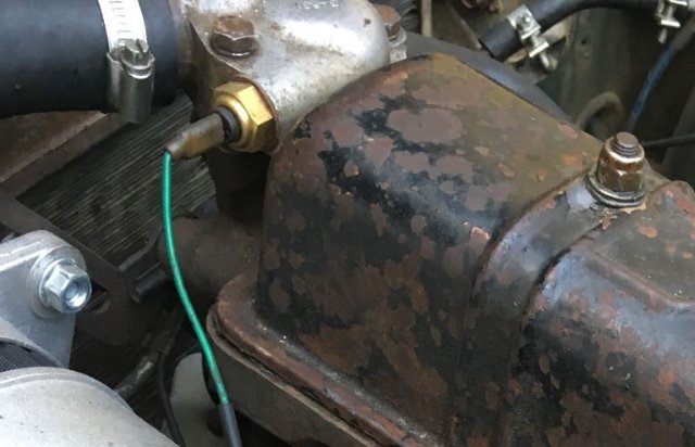

Mike Stevens wrote: Mon Jan 14, 2019 5:00 pm I think that would be ideal as it will sense the temperature on the radiator side of the thermostat. Until the thermostat opens you're not really bothered as the engine isn't up to temperature. Once the thermostat has opened, then the temperature either side of the thermostat should be the same. Assuming the thermostat is working OK that is!
When you say 'thermostat housing' I assume you mean the top bit as in your picture? I should have some around too if Chris can't find you one.

Early 2000 Mk1 had the temp sender in the thermostat housing, Later mk1 it was blanked off and the sender in the water pump housing. Mk2 had the different thermo casting with no place to drill and tap.
No idea when they stopped the earliest type

Carboy0 wrote: Mon Jan 14, 2019 3:52 pm Pinched off another forum.
I've just been out to look at my spare engine - off a 1964 2000 - and it does have the sensor in the cover, exactly as in this picture. There's a very clear exploded view confirming this in Haynes p 53.
Perhaps it was only on early 2000 engines, but the sensor is definitely after the thermostat.
Perhaps there was an intermediate period when they retained the blank casting but moved the sensor to the block?

Is it not better to measure the temperature on the engine side?
Say the thermostat fails closed, measuring on the water side would not give any indication of overheating until steam appears, whereas on the engine side the temperature would be monitored throughout.

I’m not looking to measure the engine temperature, the existing temperature sensor does that and is on the engine side of the thermostat. I am after this particular thermostat housing so that I can fit a temperature-switch into it to trigger my electric fan, rather than insert temperature a sensor into the top hose or cut the hose to insert another housing to take a temperature switch.
I did explain in my original post.
