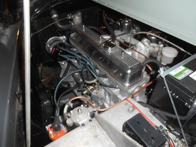

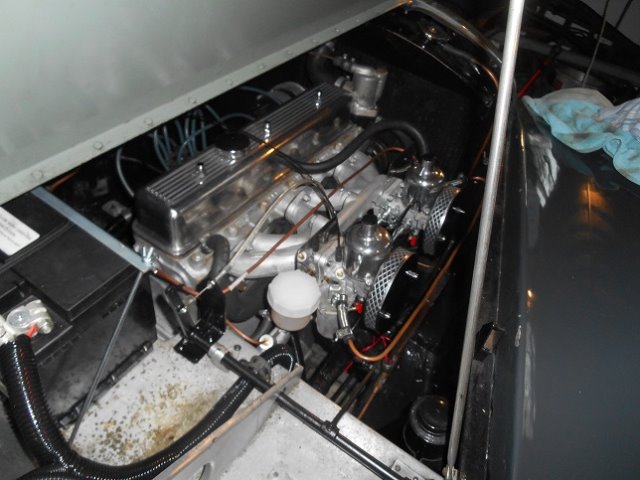

Engine runs at about 80 degrees on original AC rad with kenlowe. Oil pressure approx 70 cold and 25 hot at idle (this is read on original AC capillary gauge). It has been bored to 2600cc, Piper TR65P2TY Ultimate road cam, balanced pistons, 2500S Head skimmed 10 thou, slightly larger valves (cant remember how much but a tad), lead free inserts.
I was just looking to get best cooling for engine, however after much searching of Forums etc it seems that Oil coolers are not best recommended.
David, I am off to Classic Le Mans in the old girl next month, I will see how she behaves on trip as only done 600 miles since engine build, will get a few under her belt before trip. I will PM you re the cooler and yes in UK down in rural Kent.
And for those interested he is a pic of engine in car and the ol girl herself.
The Ol Girl
The Ol Girl
Triumph 2.6 replaces old AC 2 litre
Looks like it should allways have been there
