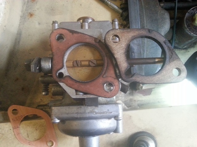

OK So sorted the HT issues, it was the condenser and the ballast. Fitted the new bits and bypassed the ballast. Cleaned out the stuck carb and fitted the new inlet valve.
Just about to put it back on I noticed the original engine side gasket has a round cut-out inside which matches a hole in the carb, however this the original two gaskets and spacers were fitted round the other way as you can see from the indents in the old one, so it was blocked. See pic,of old bits (opposite way to how it was fitted) and new gasket next to it
Does it matter? Not sure if this hole actually goes anywhere, plus the new gasket in the kit does not have the cut-out. Thoughts?

Not familiar with Strombergs but I don't believe that that hole has no purpose, why put it in otherwise? I wouldn't block it off.

I agree! I'll have to see what the other side is like.

So the hole was blocked so wasn't an issue.

the stromberg carb has a big hole and a smaller letter box hole above the big one, make sure this isn't blocked by gasket , air fliter upside down or even the wrong airbox back plate(SU type) which is with out a cut out for this hole.
If it is blocked it will run out of puff at about 3500 rpm and become very asthmatic.
